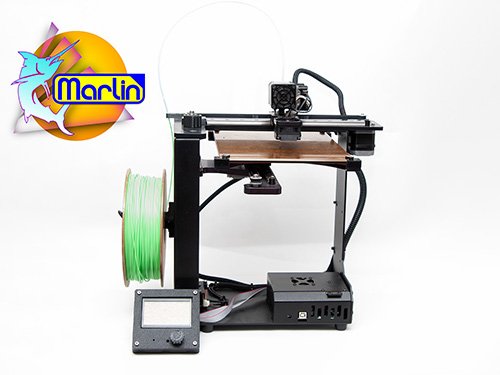

Marlin MakerGear M2 (Rev H) Marlin 2.1.3+
This article and the configuration i submitted to Marlin are written against the last model of M2, the Revision H. We will discuss the differences in other revisions to assist you in getting your specific revision work as well. But I am unable to test them myself. Some of the original firmware notes seem incorrect but many of the details about revision differences are available here - https://makergear.zendesk.com/hc/en-us/articles/360022528292
