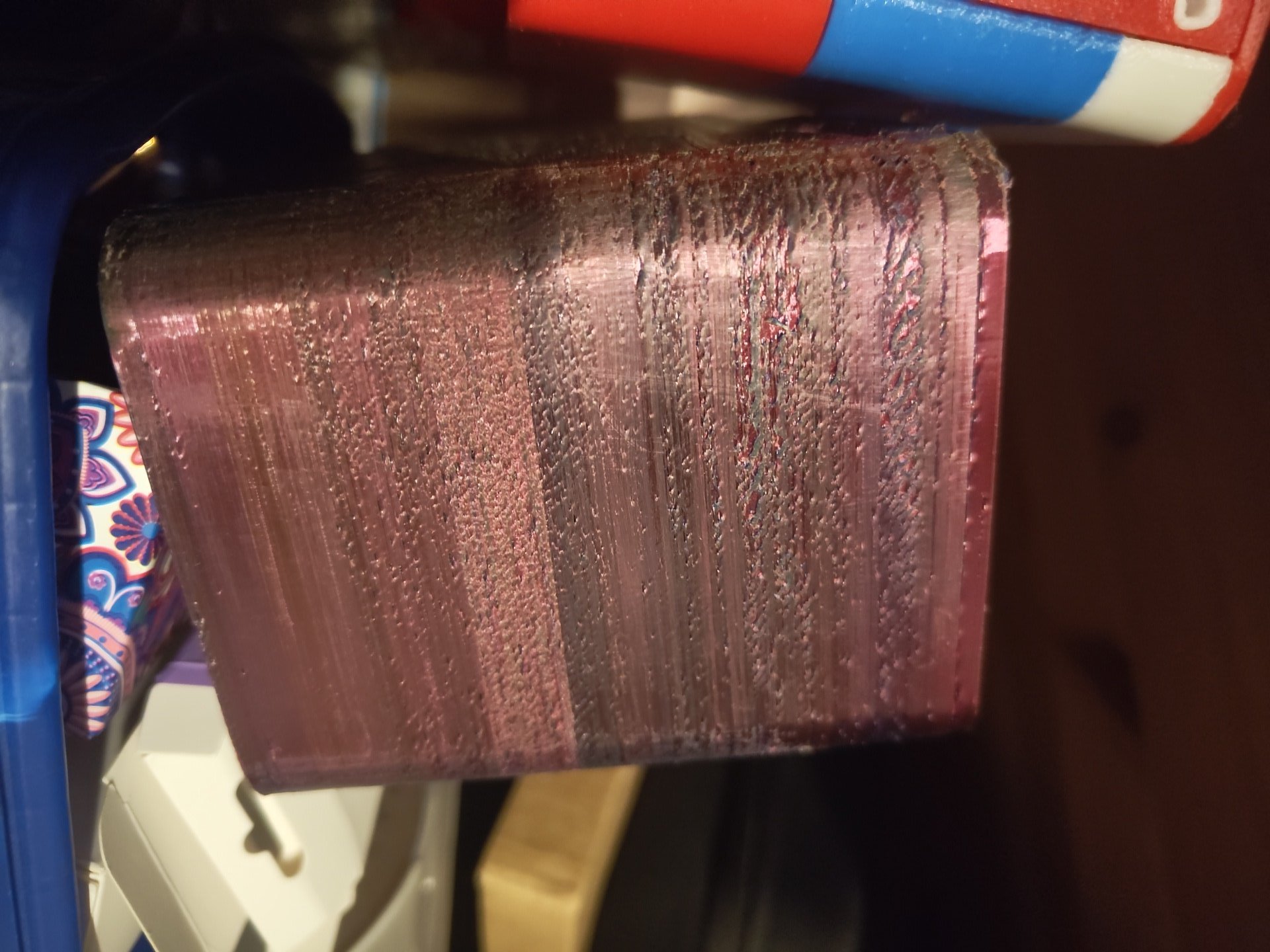

I actually only have the problem that it is too slow and I need a faster hotend.
Oh yes, and from about 1cm height the print becomes unclean.

Pretty common complaint. Many older hotends are only good around 100-120mm/s at .4 width/.2 height. Klipper helps a lot with 8 bit boards but most of these printers weren't really going to go any faster stock.
Do you have any pictures of the issue occuring? Can't promise I can help. I was dealing with some issues last night for example and would have only solved it being there.
I only print 80-100mm/s with it, but it makes messes especially with silk pla.

Hey everyone,
I've modernized my Chiron a bit.
The hotend is now a Red Lizard K1 and the extruder is a cheap dual-gear extruder.
I printed a new enclosure with the same dimensions as the original and attached a part cooling fan with a 40mm fan.
The result is PTFE at ~160mm/s at 245°C and a totally clean print... especially for such an old printer.
